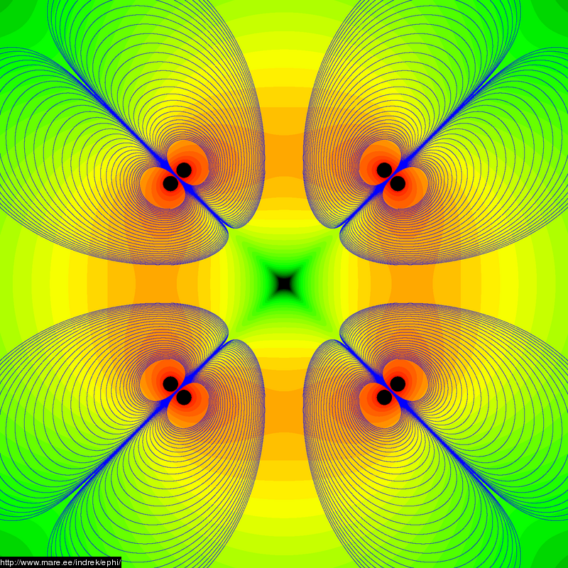

Tom Ligon wrote: Looking from the perspective of a confined plasma or electrons pushing at a field, a concave field will be stretched when you push on it. Picture air pushing out a balloon. As it stretches, the field or balloon skin becomes weaker. This setup is prone to instability. The ultimate example of a stretched magnetic field would be a loop-shaped solar prominence. When one of those stretches too far, it ruptures with a stupendous release of energy.
Not being a plasma physicist, this sounds like magnetic reconnection, and to clarify for my feeble mind to grasp, your saying that the polywell uses a convex gradient coil? pardon the questions.
Here is a picture of the fields:
http://www.mare.ee/indrek/ephi/polywell ... ld_log.png
you can see they bulge into the center.
More:
http://www.mare.ee/indrek/ephi/polywell ... _lines.jpg
http://www.mare.ee/indrek/ephi/polywell ... gcolor.jpg
http://www.mare.ee/indrek/ephi/polywell_cube_lint.png
Go here:
http://forum.nasaspaceflight.com/forums ... =5367&mid=
and search for Indrek for more.

MSimon wrote:
More:
Go here:
Thank you!
