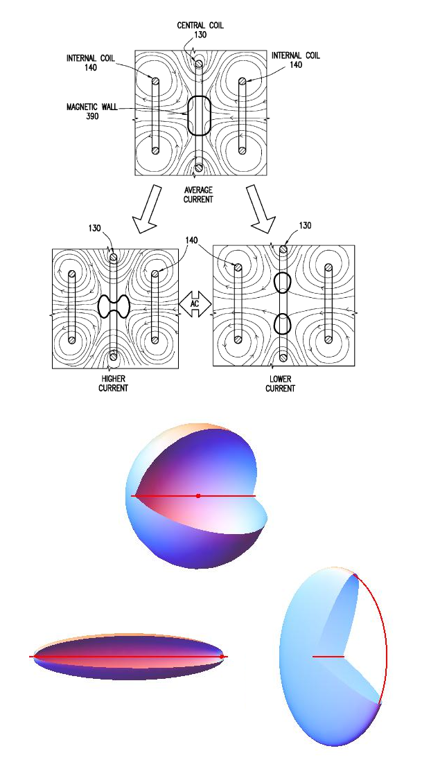

Perhaps having the internal coils and supports at the same potential as the wall helps. Also, having the attachments at the coil edge would seem to be better than where the nubs in WB-7 were located. So, perhaps the supports aren't a show stopper. This Fusion business is just full of tricks, and I think a fusion rabbit's foot needs to be included in the patent. Perhaps if we look closely at the LM pictures, hidden in the reactor design is a horse shoe, 4 leaf clover, and a rosary.

This is about some nice geometrical properties of spheroids which may, or may not, have application to offshoots of the baseline Polywell concept. I don't know enough plasma physics to do more than speculate, but I can always hope that some physicist might get inspired...
I had a gig there once, so they already have my SSN for royalty direct-deposit.Forcing a static, non-spherical field would probably be a bad idea (as Dr. Bussard said, naturally occurring fusion reactors are all spherical), but might there be some advantage in modifying the Periodically Oscillating Plasma Sphere (POPS) concept to cause field shape to oscillate between spherical and prolate spheroidal, spherical and oblate spheroidal, or oblate and prolate spheroidal? I only have a cursory understanding of POPS, so I'm also assuming here that it normally tries to keep things as spherical as possible. Would there be any tendency for particles in a spheroidal field to concentrate near the focal line or disk? In Slough's concept, FRCs are linearly translated into collision. IF Polywell particles did tend to concentrate near spheroid focal regions, could they be slammed together by driving the prolate foci, or the oblate focal circle, into a central point?
- Lockheed_CFR_Oscillation.png (220.15 KiB) Viewed 22038 times

With mechanical supports for the coils, this idea is dead in the water. You cannot get 'recirculation' that way. All the plasma on the field lines that pass outside those 'internal' rings can ExB or grad-B drift around azimuthally until it collides with the stub and is lost. So you basically turn it into a cusp machine, which has shitty confinement. QED.
Suppose you figure a way to levitate those coils, despite the fact that they are extremely unstable, since they oppose the externally-generated field. You still have a superconducting coil inside a plasma with no room for shielding (not if you want a reactor on a semi truck), and more importantly, no divertor, just a limiter most likely. That right there is going to eat your lunch, because it will introduce too many impurities.
Ok, so what if the coil wasn't a coil, what if we put beams in there? Well, you have Tri-Alpha. (This is essentially an FRC with coils.)
So I give this about 0% chance of going anywhere. My question is, what the heck is LM thinking, letting this brash young dude promise fusion in 5 years? I guess all PR is good PR, and if nothing comes of it in five years, it's no big deal to them.

Solo - worth noting that if something has to carry current into the internal coils, it will presumably be via the supports. The radial current will set up a circulating field which will tend to divert the cusp flow around the supports. At least, that is as far as my intuition goes. I can't immediately see how it would work out in 3D in the 'cusp channel'.
