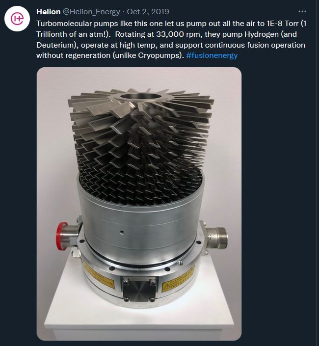

Can't turbomolecular pumps (TMPs; the label appears upside-down in the image) achieve 1.0e-11 torr though?

These tweets should give some more insights into their pumps:
Turbomolecular pumps like this one let us pump out all the air to 1E-8 Torr (1 Trillionth of an atm!). Rotating at 33,000 rpm, they pump Hydrogen (and Deuterium), operate at high temp, and support continuous fusion operation without regeneration (unlike Cryopumps).
https://twitter.com/Helion_Energy/statu ... NmUj-L5lwg

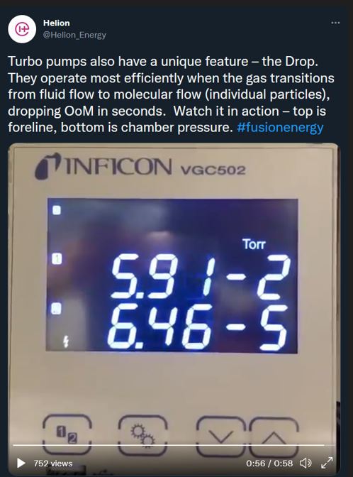

Turbo pumps also have a unique feature – the Drop. They operate most efficiently when the gas transitions from fluid flow to molecular flow (individual particles), dropping OoM in seconds. Watch it in action – top is foreline, bottom is chamber pressure.
Note that on twitter, the above is actually a video.
Helion is still going to use turbomolecular pumps for Polaris.
They have high throughout, steady operating, compatible with tritium and high temperatures.
Cryo panels in contrast are much more difficult to engineer with, plus it’s where all the tritium lives.
