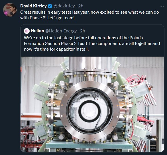

https://twitter.com/dekirtley/status/16 ... 23648?s=20We’re on to the last stage before full operations of the Polaris Formation Section Phase 2 Test! The components are all together and now it’s time for capacitor install.
Cool video of construction of the formation- test- section.
