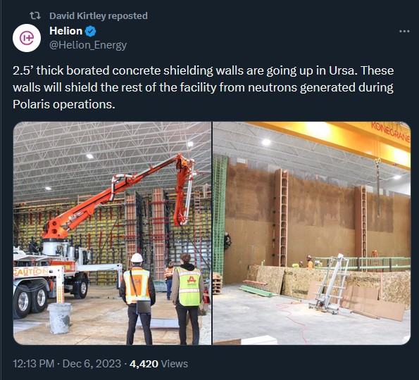

2.5’ thick borated concrete shielding walls are going up in Ursa. These walls will shield the rest of the facility from neutrons generated during Polaris operations.
https://x.com/Helion_Energy/status/1732 ... 50670?s=20
