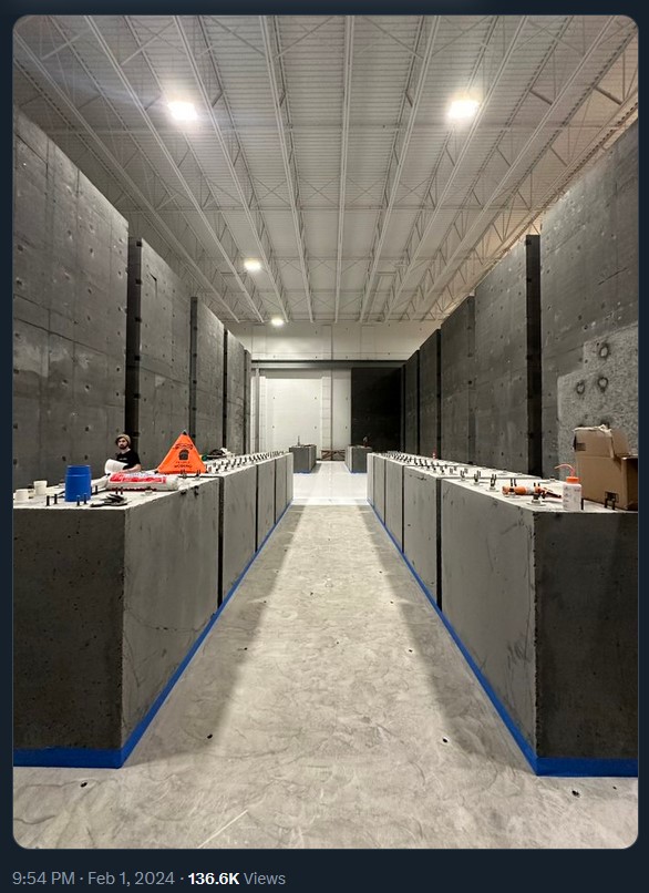

Sam Altman:
where @Helion_Energy will soon start to install polaris:
https://x.com/sama/status/1753250549045018728?s=20

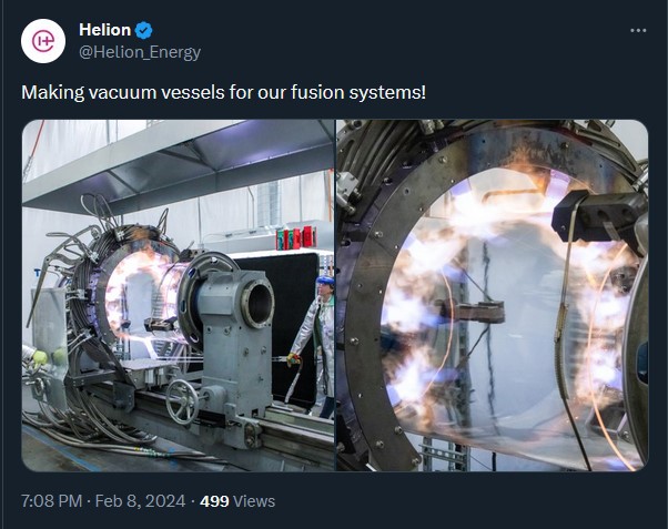

Making vacuum vessels for our fusion systems!
https://x.com/Helion_Energy/status/1755 ... 68320?s=20
