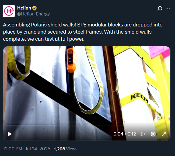

Looks like shield walls are complete and Helion is ready to test at full power:
https://x.com/Helion_Energy/status/1948412871622455508
Screenshot 2025-07-24 123311.png (252.51 KiB) Viewed 60835 times

I know they want to demonstrate it before the end of the year at the latest, but they are trying to get there sooner. Their last post says that they are ready for operation at full power. That means that they could theoretically (if they are very lucky) get net electricity in one of their next shots. More likely, they will be ramping up power, check what goes well and what does not, make adjustments, then rinse repeat.
