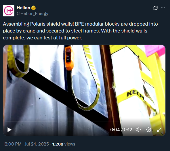

Looks like shield walls are complete and Helion is ready to test at full power:
https://x.com/Helion_Energy/status/1948412871622455508
Screenshot 2025-07-24 123311.png (252.51 KiB) Viewed 852 times
