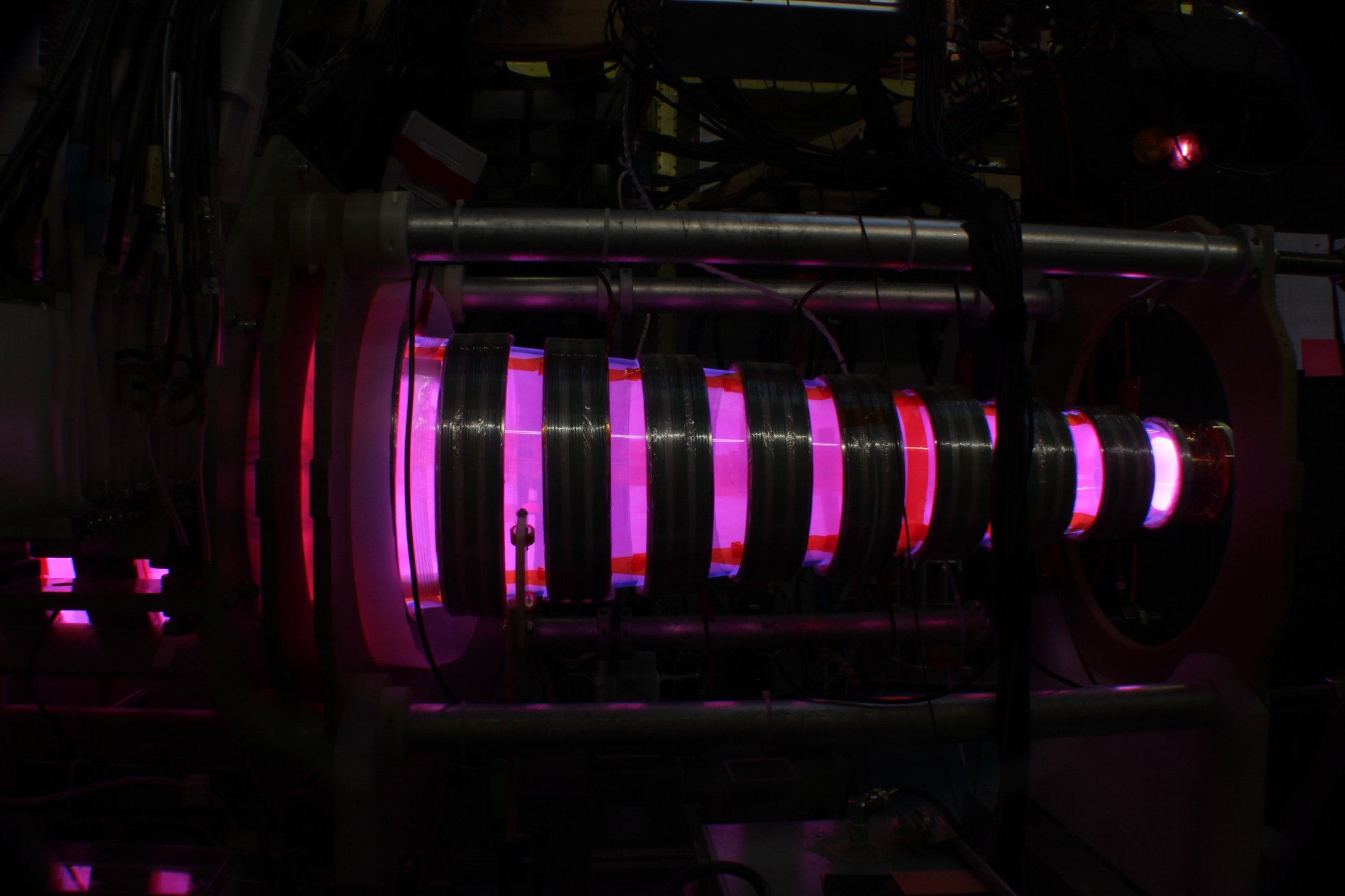

Got a little something for you guys :)
Helion has a new prototype. Looks shiny :)
