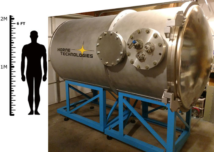

New 2nd gen chamber back from paint! Now the real works starts.

* the earlier picture shows the plasma I glow mode. I assume that's just so we can see it, and that vacuum pressure is actually much higher.
* I'm seeing largely a layered 2D configuration. So it makes me wonder:
** what is the theory of confinement? Expected confinement time?
** what kind of data are you hoping to collect? I guess this harks back to someone earlier question about diagnostica and ports and measurenents.
Of course I don't mean to pry and just say it's classified or whatever...i'm just a random person being curious and nosy.

Happyjack,
Thanks for your questions and good observation. I will answer what I can. In order to visualize the plasma and field the pressure must be fairly high, not necessarily an operating condition. Generally, in any of these type of containment systems, Polywell, or even LM, there has to be a minimum amount of plasma to generate increased beta conditions. That being said, the higher the pressure the more interaction you have with cold gas increasing ion-ion thermalization. This is probably the most significant loss mechanism. We will attempt to mitigate this as much as possible.
What do you mean by 2D configuration? The video and pictures you see are of the spindle or biconic cusp configuration. This is a good test bed for the technology and "simple" to construct: https://en.wikipedia.org/wiki/Biconic_cusp It is representative enough of many designs and a great place to start. I think that every plasma researcher should have a superconducting biconic cusp device at their disposal and would be happy to produce a commercial system if there was a market.
Tanner
Re: 1st Superconducting High-beta Device
As I recall Dr. Park's talks a few years ago, the beta = 1 condition with 5T superconducting magnets suggested a plasma pressure of some stupendous number like 120 atmospheres! High-performance steam boiler stuff!
Dr. Bussard was always concerned with fast ion, slow neutral interactions, which produce a slow ion and a fast neutral. The neutral cannot be trapped and is lost.
