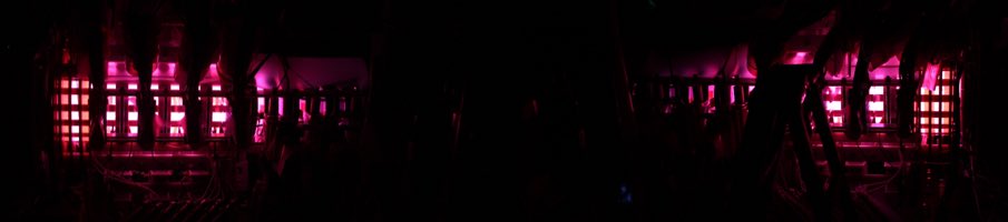

Small Tweet with picture of Venti by David Kirtley:
Speaking on Venti fusion updates at the @ARPAE ALPHA program's annual review! @Helion_Energy #fusionenergy
