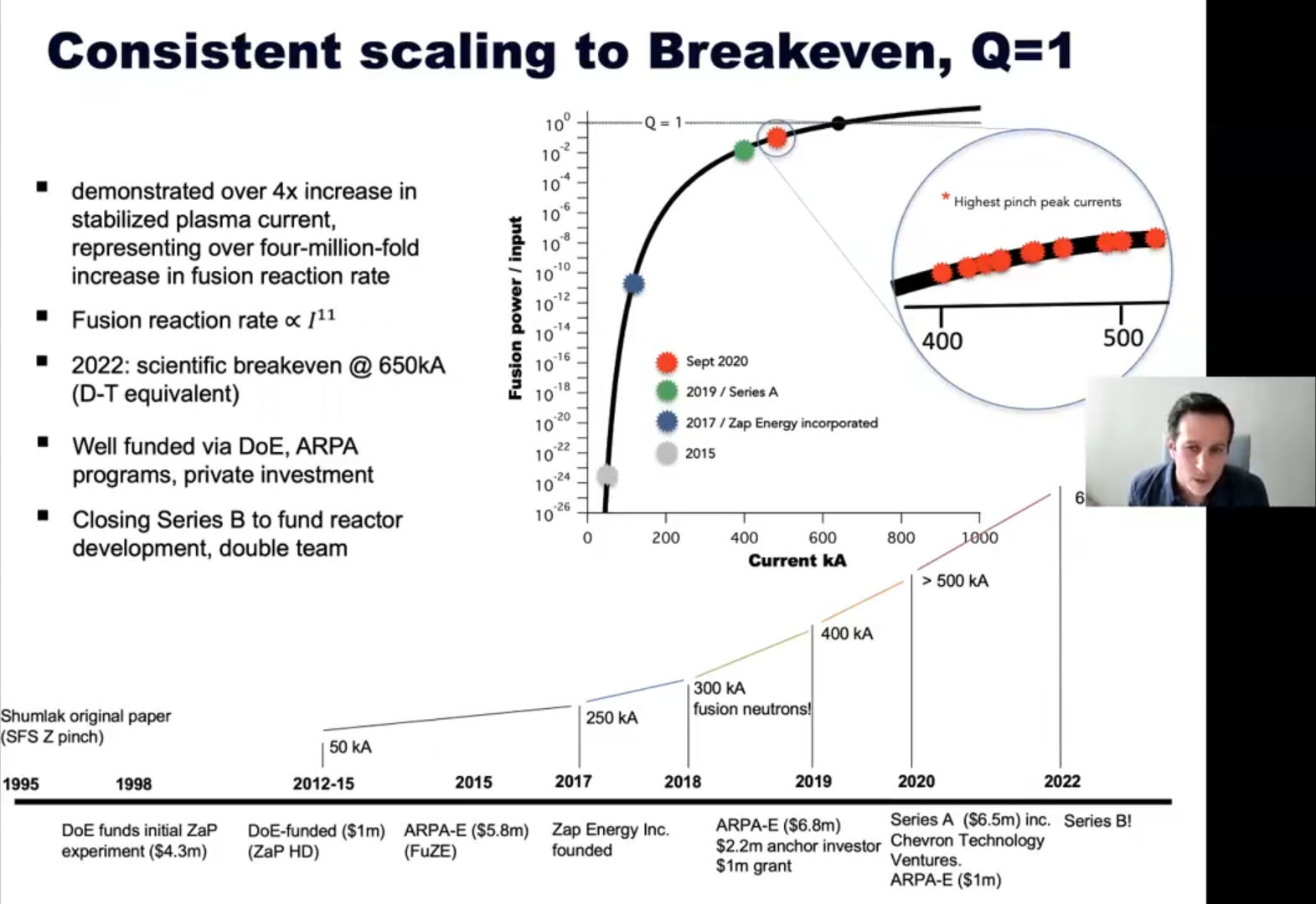

ZAP has a new video on LinkedIn that shows the progress they have made in recent months.
In a new campaign started in September of last year, they achieved over 500 kA peak pinch currents (of 650 kA needed for break even) and their scaling laws are still holding up. What is remarkable is that they were able to drive Fuze to these currents. Back in April 2018, Uri believed that they would need a new device to go significantly above 300 kA, since the structural integrity of Fuze would not allow for more.
My guess is that they just took the risk and decided to see how far they could take it, since the next prototype was already planned anyway.
Fusion gain in Z Pinches scales scales with current to the 11th power.
According to Scott Hsu they were at over 10^17 keV*s/m3 in 2018, when they were somewhere around 300 kA. With ~530 kA, they should be over 500 times as high. So approaching 10^20 keV*s/m3 and there are some other knobs to turn in addition to the current.
So they are VERY close to notional break even, which is still planned for 2022 (at least according to this video from April).
So yeah, going up a bit more to 650 kA should get them to notional, even scientific break even, or at least give JET a run for its money. I am sure they will try to get that prototype up higher too, like they did with Fuze.
I have been looking for another, more accessible source for this video, but haven't had any luck. If anyone finds it, please post it here.
https://www.linkedin.com/company/zap-en ... fe/energy/

Re: Z-Pinch Renaissance
Sun Jun 20, 2021 1:56 pm
I don't have linkedin so I cannot see the video, but just out of curiosity, did they mention the plasma radius and the Vz (shear velocity) of that 500kA experimental run?
Not that I could see. What they are showing is a graph with the predicted scaling towards Q(sci) and their experiments on that line. So I assume that means that they have kept the other parameters at a useful level.
Here is a screenshot for you, bud:
Finally got to the linked-in video. Less interesting than your post, but confirms they are up around 500KA with scaling intact.
Frustrating for me that I don't really understand the challenges they face in raising the current. We know MAST is a mega-amp, fwiw. But if the difficulty scales with e.g. the 17th power of current, they might not make it. Just floundering, but I wish them the best: they certainly get the prize for conceptual simplicity....
And why bother making the pinch so darn long? 50cm is a hell of a spark-gap.
