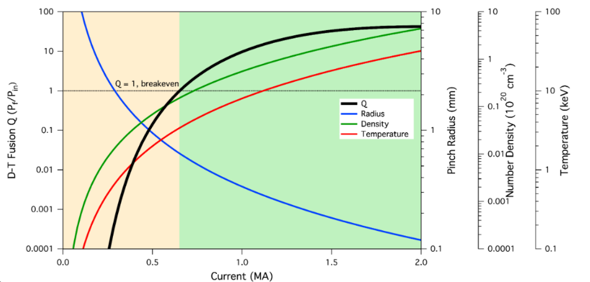

Frustrating for me that I don't really understand the challenges they face in raising the current. We know MAST is a mega-amp, fwiw. But if the difficulty scales with e.g. the 17th power of current, they might not make it. Just floundering, but I wish them the best: they certainly get the prize for conceptual simplicity....
To visualize the challenge you can think to the current into the machine as a viscous fluid, the higher the current (the viscosity) the higher the influences of the MHD instabilities of the boundary on the core pinch.
Thus, to be able to increase the current and overcome the break-even line while keeping a stable Shared flow, the solution is to decrease the pinch radius "a" so that it will not "feel" the boundaries instabilities.
And this is why I was asking in my previous post what was the pinch radius of the reported experiment, because a high current without a pinch radius will not allow the black line to cross over the "Q=1", but will transform the black line in an asymptote to "Q=1"
This point (as you can see clearly from the picture down here) will also limit the commercial "Q" of such a reactor to a single digit number, unless they had some new breakthrough that allows the pinch to be stable irrespective of current and pinch diameter.

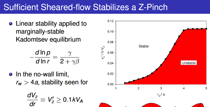

RERT wrote:
Sun Jun 20, 2021 8:33 pm
And why bother making the pinch so darn long? 50cm is a hell of a spark-gap.
Because the plasma pinch stability due to flow shear increases with pinch length.

Re: Z-Pinch Renaissance
Sun Jun 20, 2021 8:24 pm
Not that I could see. What they are showing is a graph with the predicted scaling towards Q(sci) and their experiments on that line. So I assume that means that they have kept the other parameters at a useful level.
Here is a screenshot for you, bud:
Thanks a lot!
I projected the "q" values of that diagram onto the chart I got above and I calculated a radius of slightly less than 1 mm, so perfectly in line with FUZE operating parameters.
I would say that this is a pretty good news as for the accuracy of their models, they need to to find a suitable working way to reduce the pinch diameter and verify that the Alpha will escape without thermalizing during the pinch.
If they can manage these two points, overcoming the break even line should be trivial.
I am very interested to see what they will present in the coming conferences.
Mon Jun 21, 2021 11:47 am
Thanks Giorgio. The above is very counter-intuitive! I had already found and skimmed the paper you cite, but couldn't see any reference to pinch length. Have you got a reference for the above? Also surely creating the sheared flow must be harder over a longer pinch? Similarly couldn't see any relation between pinch length and confinement time, although the 'dilution' of end/electrode leaks is pretty clear.
The paper did obliquely mention length via the statement that the pinch was a uniform linear source of neutrons. Then obviously the longer the better: the same current is constraining more plasma and creating more fusion power just by having a longer pinch. (slaps forehead)
RERT wrote:
Mon Jun 21, 2021 1:47 pm
Exactly, once the pinch is established (and as long as there will be enough plasma and current) the pinch will stay stable, and because fusion is for unit of length, the longer the better.
Here on page 24 you have the general formulation for D-T that they are using for their modelling. You can extrapolate the binding between Power, Pinch Length, Pinch radius, plasma V(z), and all other parameters and respective limits for each.
https://wippl.wisc.edu/pub_files/journal/Shumlak928.pdf
