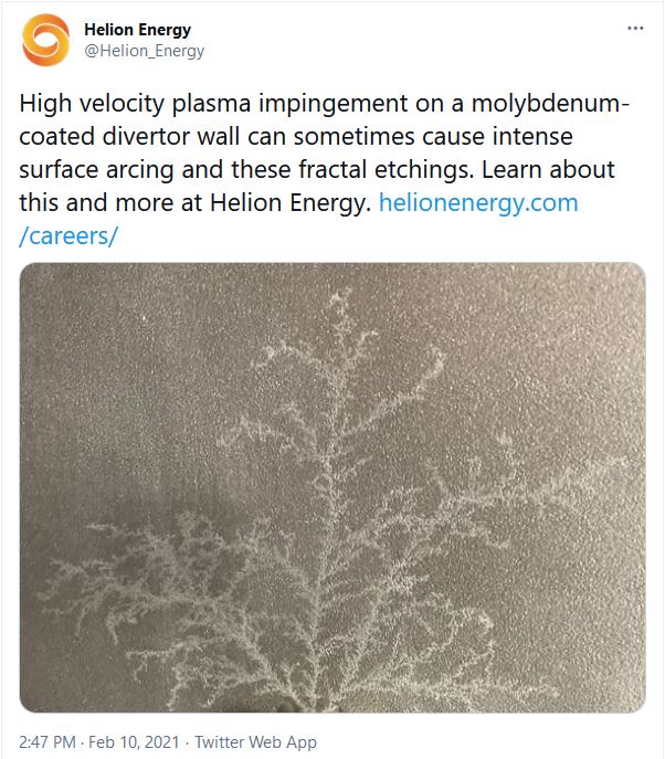

And then, the most recent thing they posted on Twitter is this:
1. They are working on a divertor.
2. That divertor has a molybdenum-coated wall.
3. They have issues with high velocity plasmas causing arcing and erosion on that molybdemium coated wall.
I would say that this is a pretty good position to be in. I think only CFS and (maybe) TE have even worried about divertor designs(!) until now (and they are building Toks which absolutely require them). To my knowledge none of the other teams have actually built one.
