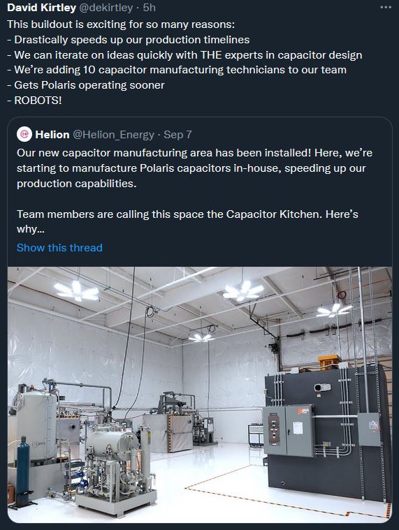

David Kirtley weighing in on the purpose of the new capacitor production facility. Looks like Polaris timeline will be accelerated by this.
Brilliant. Helion is amazing.
