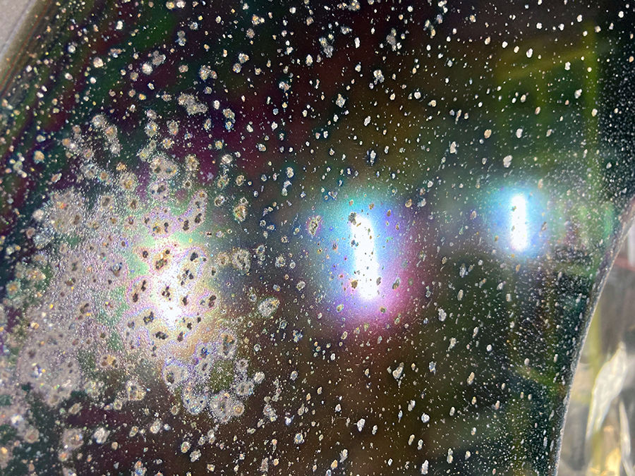

Tweet by Helion today:
Helion just opened the 6th fusion prototype after an unprecedented 16 months of continuous vacuum and repetitive high-power fusion operations! Now upgrading to the Mark 2 divertor with advanced materials and magnetic shielding. Mark 1 divertor wall after 16 months:
https://twitter.com/Helion_Energy/statu ... 1095695361

Re: More Helion Energy news....
Interesting small bit of information in a response from Helion:
" This picture is more deposition, rather than erosion. We'll know more soon as we get in-depth measurements with SEM (scanning electron microscope) and EDS (X-ray spectroscopy)."
https://twitter.com/Helion_Energy/statu ... 1234880514
It might not be a good news because if it is only deposition they might have 2 problems to solve, deposition on the divertors and erosion in some other part of the machine.
From what I understand, the deposition is from erosion in the unshielded part of the divertor. Basically what happens is that the fusion reaction creates a very high energy jet on axis. The divertor in this case is used not for electricity production but to slow down that jet.
They are already developing a new divertor with new materials, magnetic shielding and other means to mitigate those issues. They seem to have several options there too. So hopefully, it is not too big of a deal and can be solved relatively quickly. Personally, I think that they are in a rather good place, when they have to worry about problems like these. I think most other teams are not even close to worrying about things like divertor erosion/material deposition.
From my knowledge, the erosion and the redeposition process over the divertor itself (which allows an absence of plasma contamination), has been so far proved experimentally only for Tungsten coated divertor and only in a very limited range of plasma laminar flows.
Turbulent plasma (and transient cases) still need to be investigated for Tungsten, and no public data is available for Molybdenum for linear, transient and turbulent plasma modes.
The last 2 cases, transient and turbulent, are the most worrisome for molybdenum because it has an average of 20 times more sensibility to erosion than tungsten.
