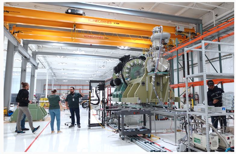

New Helion Newsletter is out:
After a lot of outstanding progress, I wanted to recognize the tremendous amount of work our team has made toward getting Polaris built and operational. The last few months have paved the way for several important assemblies to be completed prior to the end of this year. Our production team is constructing new builds daily, our engineering team is testing on the floor, and our machine shop is milling new parts for Polaris. Some big things are beginning to come together:
Our new machine shop, Carina, is up and running. Outfitted with six mills (plus two more arriving next week), Carina will drastically improve our manufacturing capabilities and speed up our assembly timelines. First parts are under way!
The Polaris compression coil forgings are beginning to arrive and are being cut in Carina now. Once machined, these will be our biggest electromagnetic coils yet.
Our test engineers validated a new gas injection system for our Polaris Formation Test (shown above). This gas injection system will inform the final gas injection design for Polaris and our following commercial devices.
We announced our support to Senators Carper and Capito for their call to implement a right-sized regulatory framework for fusion in the United States. I’m excited by the progress being made at the federal level that enables fusion to be safely and rapidly deployed.
Helion was featured in a video by Electric Future that now has close to 2 million views. Watch to learn more about our approach and see some of the Antares facility as it was coming together in late May.
A huge shout out to our engineers, technicians, and machinists as they’ve been working hard to get things done and build stuff that works. If you’re interested in joining the Helion team, now is a great time.
