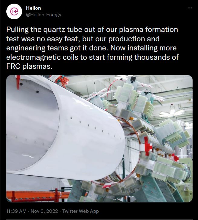

Pulling the quartz tube out of our plasma formation test was no easy feat, but our production and engineering teams got it done. Now installing more electromagnetic coils to start forming thousands of FRC plasmas.

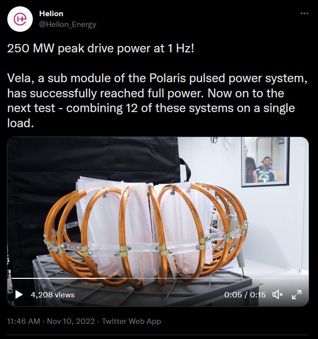

250 MW peak drive power at 1 Hz!
Vela, a sub module of the Polaris pulsed power system, has successfully reached full power. Now on to the next test - combining 12 of these systems on a single load.
