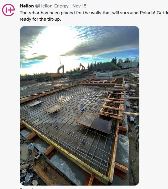

More progress on the construction of the Polaris building:
https://twitter.com/Helion_Energy/statu ... 9969880070
Hopefully this is watching history in the making!
