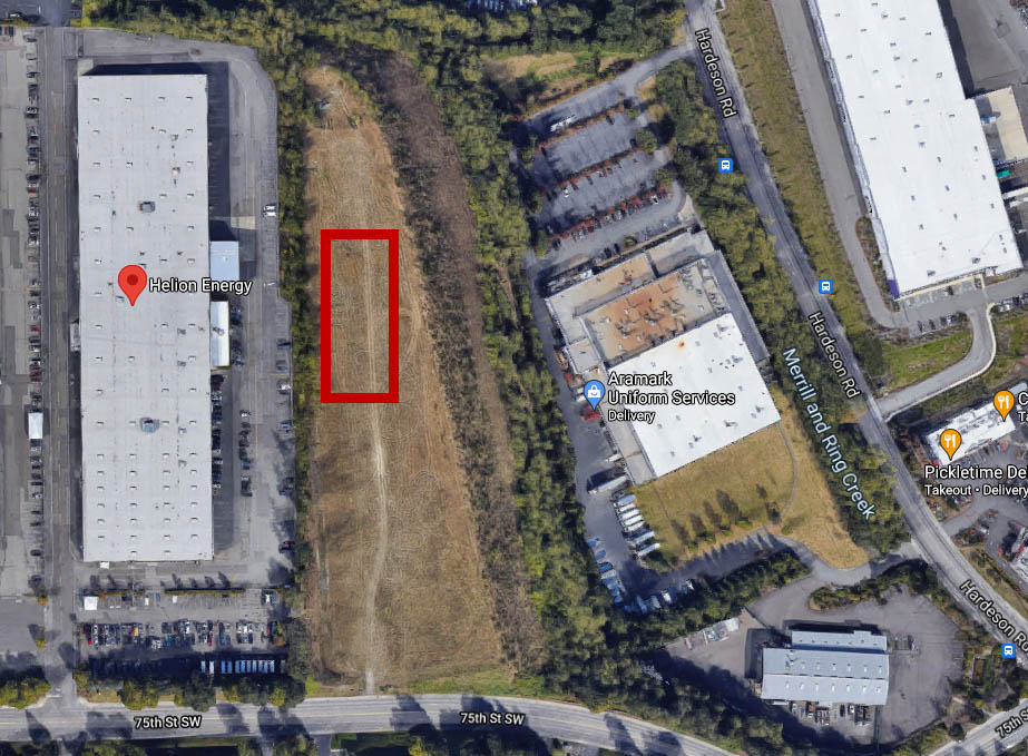

Took the liberty to find Helion's Antares facility on Google Maps and mark the (estimated) location and scale of Polaris next to it.
