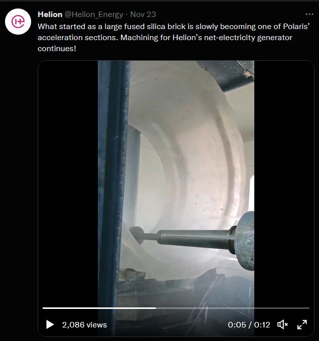

New short video on Twitter:
What started as a large fused silica brick is slowly becoming one of Polaris’ acceleration sections. Machining for Helion’s net-electricity generator continues!
https://twitter.com/Helion_Energy/statu ... rZXIBJcR1A
Nice picture, Helion is focusing on their manufacturing process, smart.
There are going to be more than 1 successful fusion project, but time to manufacture will be THE key. If it takes 4 years minimum to build a fusion generator from one company and 2 years from another, which one is going to get the order? And that is just the start of the decision process. How about delivery of components? Then there is the experience with the system, if one company has 10 in service, another company has 1 which are you likely to buy?

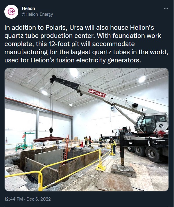

In addition to Polaris, Ursa will also house Helion’s quartz tube production center. With foundation work complete, this 12-foot pit will accommodate manufacturing for the largest quartz tubes in the world, used for Helion’s fusion electricity generators.
