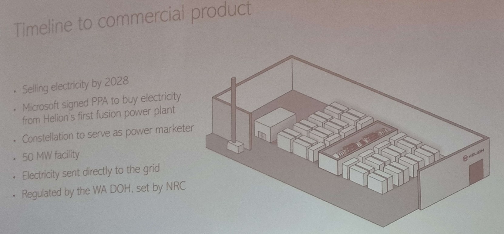

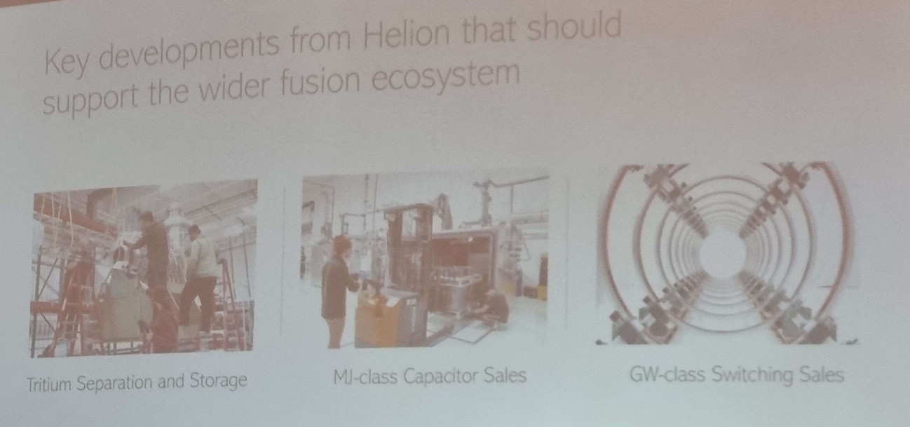

From David Kirtley's talk at SOFE. darn the capacitor banks are huge compared to the fusion core. From what I understand from what David told me, the banks get smaller with higher pulse rates, but I am not sure how all of this fits together with the Microsoft plant.
Some spin- off products for the wider fusion community, I guess.

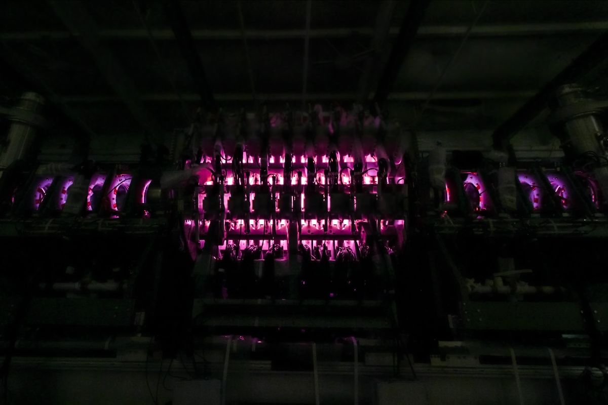

Polaris Formation test: We completed construction on our Polaris Formation test last month and have begun initial plasma operations (pictured above). The testing in this machine will allow us to experiment with higher electric field and magnetic flux FRCs and a range of new fuel, diagnostic, pre-ionization, and control technologies!

One small bit of information about the capacitor banks in the drawing. The individual blocks have shielding and fire suppression.
