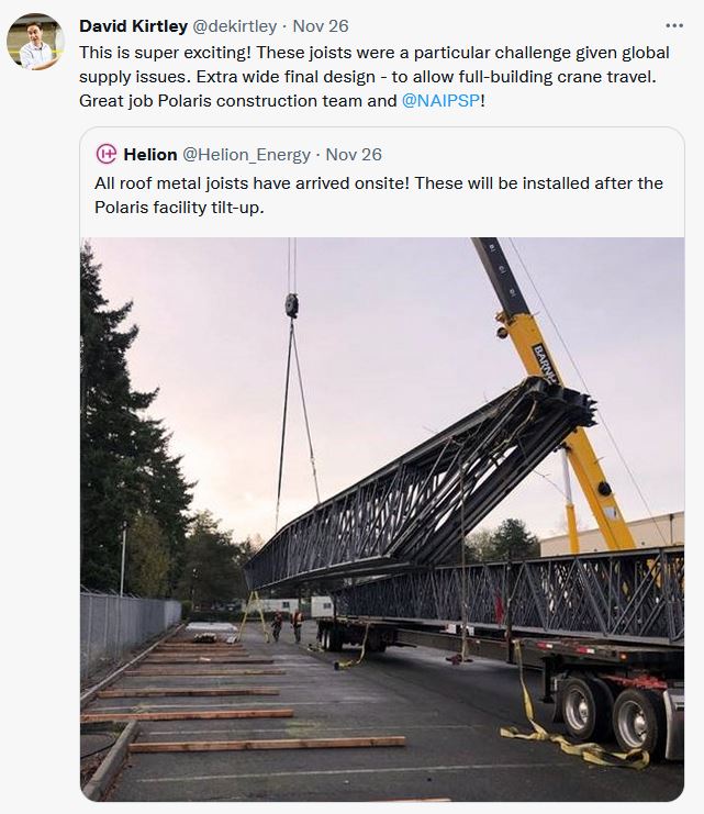

Roofing joists have arrived at the Polaris build site. David and his team are successfully working around global supply issues:
https://twitter.com/dekirtley/status/14 ... 1736636421
These joists were a particular challenge given global supply issues.
Makes me wonder what other supply challenges they are facing and how it will affect the schedule.
