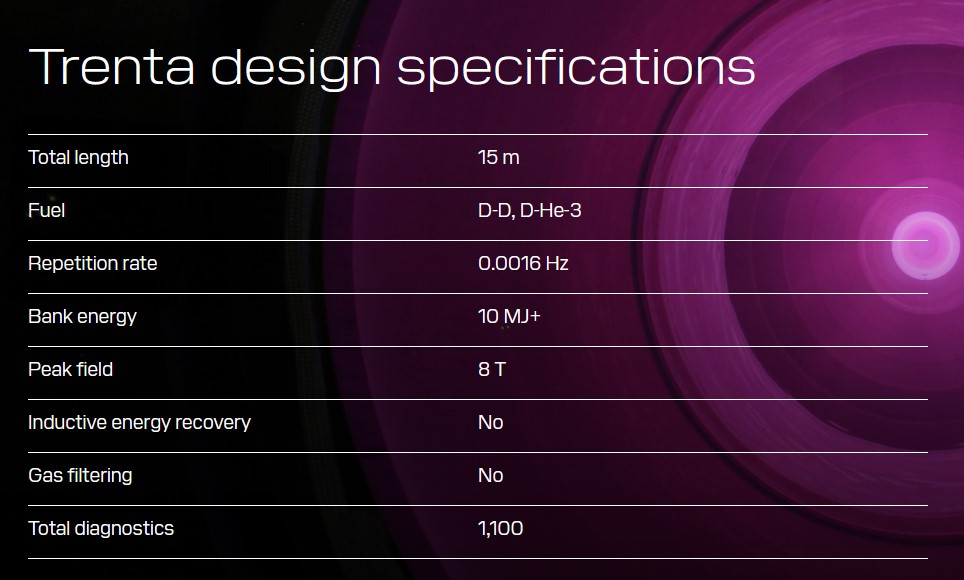

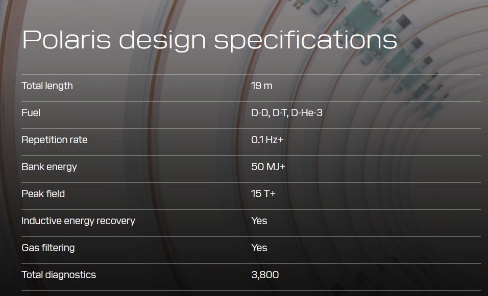

Posts: 6970
Design specifications for Trenta and Polaris:
SJ
In the paper, Trenta is reported to be >0.5 m radius and Polaris as >1 m diameter. I found that to be odd and wondered if what was meant was Polaris was >1 m RADIUS? Looking at pictures I am guessing it was a typo in the paper and it should have been >1 m radius.
