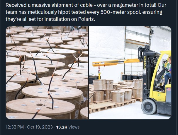

Posts: 6970
Helion got the cables for Polaris delivered recently. 1000 km worth of cabling! That is a lot of cables.
Received a massive shipment of cable - over a megameter in total! Our team has meticulously hipot tested every 500-meter spool, ensuring they're all set for installation on Polaris.
https://x.com/Helion_Energy/status/1715 ... 02055?s=20
And high voltage tested them already.
We desperately need to take every bit out of the schedule possible. Helion seems to not miss anything after their experience with building so many prototypes. News from Helion and Zap will shake the world energy tree.

To be clear, this is the formation test and not the actual Polaris machine, which is still under construction. The formation test does help them test things, learn and reduce the amount of bugs they will encounter with Polaris early on though.
They just got their magnet wire so lots of work. I was surprised that they make their own magnet coils.
