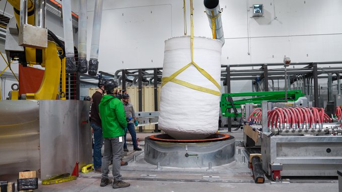

The start of a Polaris vacuum vessel being removed from its spinning mold.
These large tubes are made from fused silica (quartz) and will soon be machined into final vacuum vessels. Each end of Polaris will have a large tube, and our team is making several to select the best performers.
