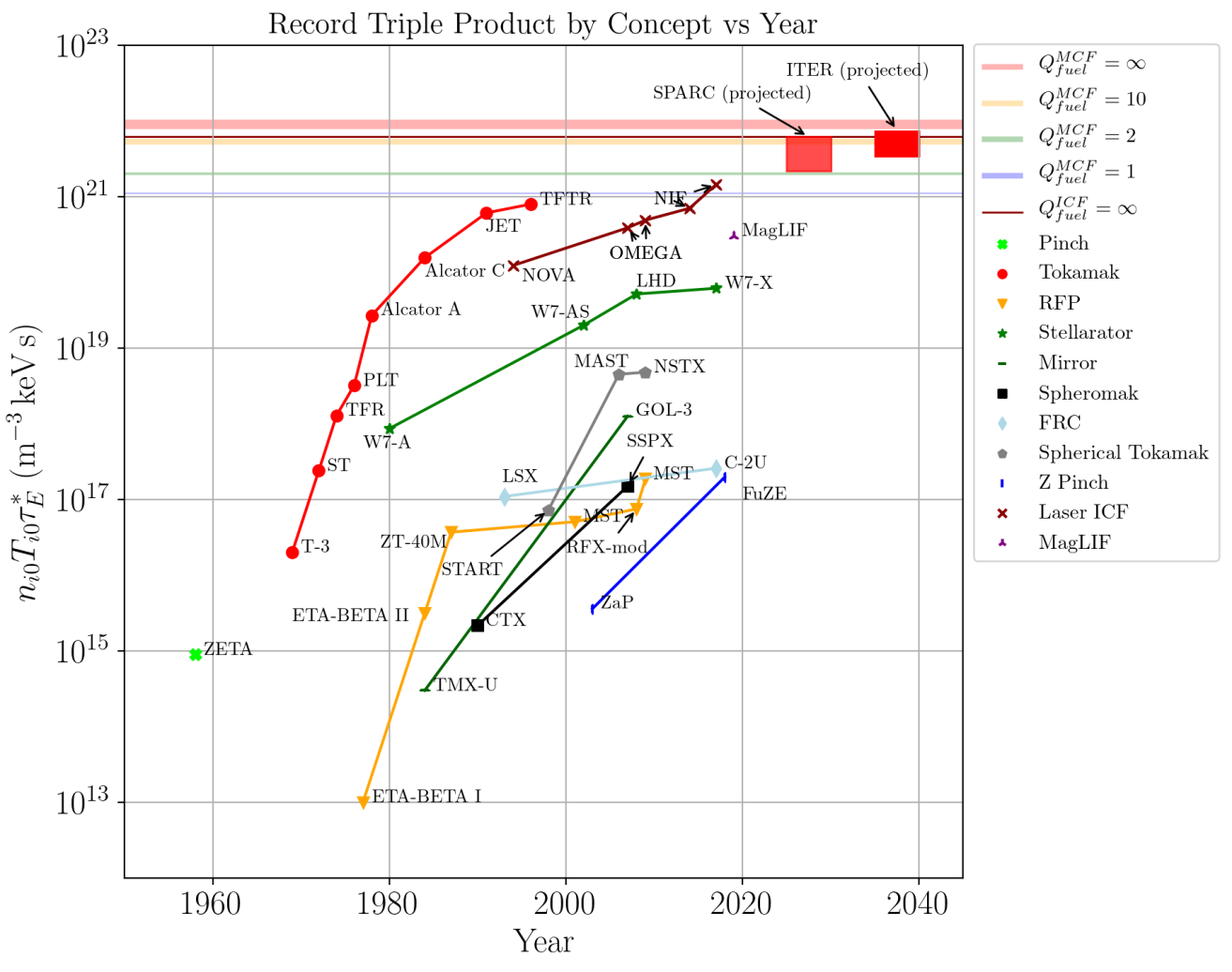

by crowberry
Picture from: https://arpa-e.energy.gov/sites/default/files/2021-03/430_Holland.pdf
The risk involved with the most advanced fusion projects has obviously decreased, but success is far from certain at this moment. The gain is so large that it is attractive to persons with deep pockets even if the risk of failure is still significant. This plot of the fusion triple product shows clearly that there is still a lot of ground to cover to reach Q=1 and to go further to an economically feasible Q-value. Only a few of the dark horses can be seen on this plot, but the message is clear.
Note the position of MagLIF on this plot. Unfortunately the target is basically destroyed in each shot. Commercial fusion based on MagLIF would of course need a new setup where the hardware survives the pulses.

crowberry wrote:
Mon Mar 22, 2021 9:21 pm
Mixed feelings about that plot:
From what I gather, Helion demonstrated around or just under 10^20 keV *s/m3 with VENTI (their previous smaller prototype that they had built for ARPA-E Alpha).
MIFTI/MIFTEC is in the same region with their Staged Z- Pinch, though their design is at an disadvantage compared to Helion because recouping (a useful amount of) the input energy is not possible.
NIF's numbers were IMHO exaggerated. They were nowhere near Q>1 unless you do some strange kind of numerology. Practically, they are off by a few orders of magnitude.
LPPF claims 2x10^20 keV *s/m3. Though AFAIK, that has never been peer reviewed.

Yes, well, fusion researchers were engineering fusion reactors back in the 1950s. Then they realized they didn't know enough about fusion science to engineer proper reactors and decided to focus on that for a while. Then, in the 1970s, Hirsch and Bussard tried to steer back to focusing on engineering, and the number of active fusion research projects was reduced. Then more research was needed, and so on. There have been various studies on fusion power generators, energy capture, reactor materials, etc. Of course those areas need to be researched, but they're still ultimately pointless without a working fusion power plant. And, unless I am deficient in my understanding of the current state of fusion research, of the many hours of fusion experiments that have been run, precious little of that has actually been under the actual conditions that would hold in an operating fusion power plant.
The history of fusion research is littered with the carcasses of great ideas that should have worked, but didn't when tested under real experimental conditions, or that worked wonderfully under one regime, but not so well when conditions were scaled up. I'm not sure how things are any different now. As much as we all like to criticize ITER, there's a good reason they continually emphasize that the primary purpose of the experiment is to study a "burning plasma". It's because there is probably still much we don't know about how a burning plasma behaves, and can't know until we can consistently achieve those conditions experimentally. I don't see why other fusion projects would be in a much different position. Engineering is the ultimate goal, of course, but science is still the path to that goal. Both ends might possibly be achieved in a single device, but a working demonstration reactor is, as far as I know, still a science experiment at this stage of fusion research. Is there a company/concept for which this is not true?
