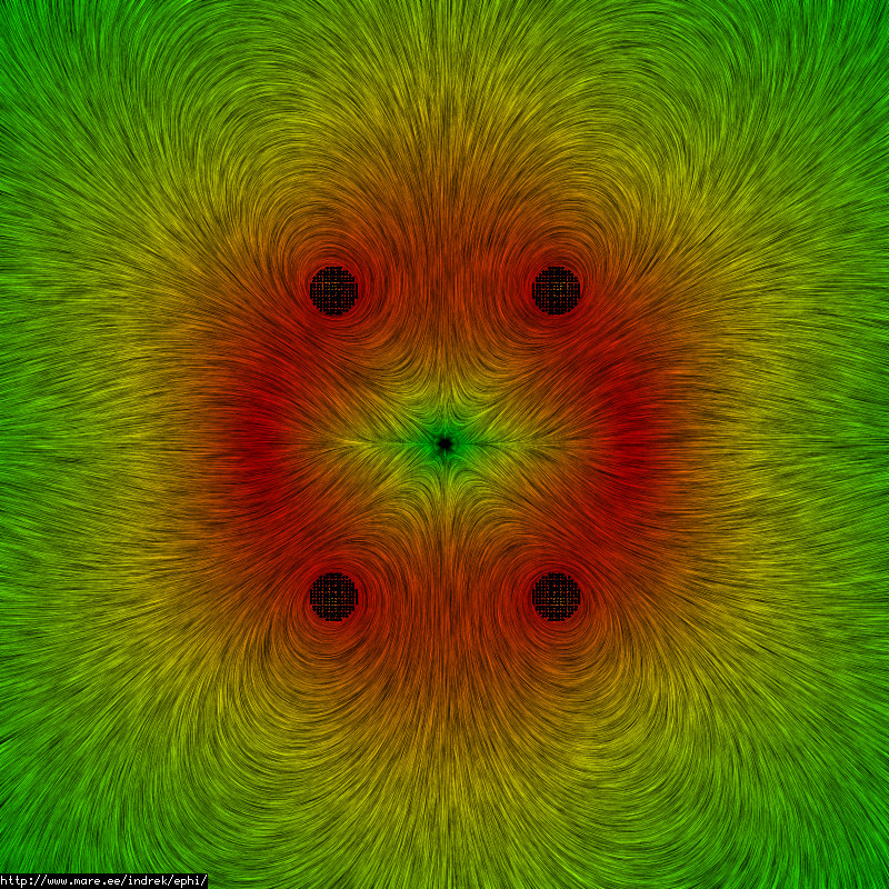

I think the electrons mostly circulate in and out of a cusp and do not make a full circle along the field lines. Like in my simulation videos. Other simulations have been done by different people and they show the same thing.
When an energetic electron gets close enough to a coil (penetrating field lines due to collisions) then it might just have enough energy to make full circles around the coil. That's also what my simulations have shown. Due to collisions the electrons will certainly reach the coil-orbit position (lets call it the high-orbit;). My simulations have shown that once there they will circle around the coil but will cover the coil entirely - and are not constrained to cusp areas. In this sense the support structures between the coils are bound to get in the way.
But to illustrate my point here's an image of a simple polywell.
Note: this is a cross-cut of the cube polywell. See http://www.mare.ee/indrek/ephi/pef8/polycut.png for a geometric interpretation.
As you can see the field lines from the cusps fan out a looong way - taking electrons many times the size of a coil away from the system. Not to mention far-off the fields get weaker and the gyro-radius increases risking even more loss.
To get good full round circulation along field lines from and back into the machine for electrons that have picked enough energy to escape the coil potential (our problem fast electrons) the machine would have to be huge. And even the wiffleball might squeeze the electrons to a tighter beam in the center - exactly where field lines go miles away without helping us and our way-too-fast electrons.

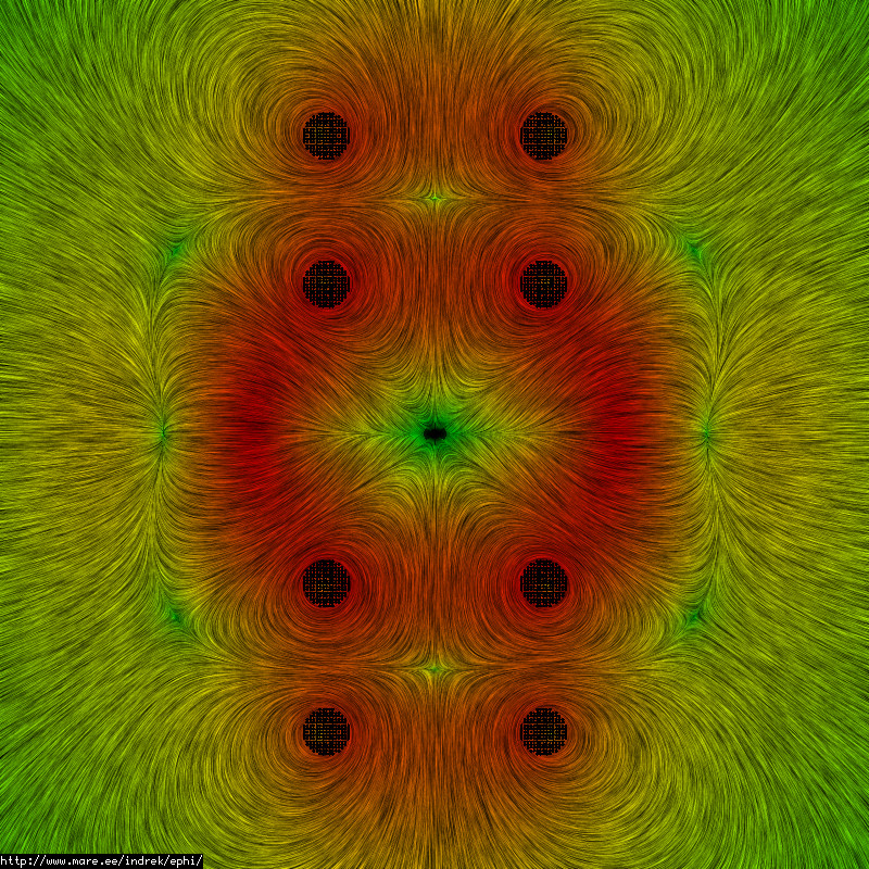

But here's why I started responding to this thread in the first way. What happens if we put a second set of coils opposing the fields. Would that force more recirculation? See for yourself:
Here the secondary coils have half the current the primary ones. Btw it's easy to try things like this in ephi, took me 10 minutes of scripting to get this image. Here's a corresponding coil system:
Would this work? would it help? I have no idea.

In regards to the post above with the extra coils added outside the faces, would it be possible to look at a model with a set of smaller coils above the cusps as well well as or in lieu of the extra "reflector" coils at each face? From looking at the pic of WB7 in operation it looks like the cusps are the primary sources of electron loss.

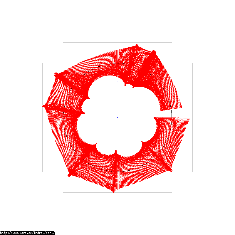

What I meant by electron going around the coil and also round the coil is this:
Well I'm not sure whether things like this will dominate the process cause I have to play with parameters a bit to get something like this (have to give enough energy to penetrate the mirror to make full circles and also be close enough to the coil and also have proper direction) - so that combination might be rare and not really matter. But it can certainly happen.
- Indrek

Actually. As this is the only very obscure way I have seen electrons making full circles around the coils (following field lines "back" into the system), I don't believe recirculating electrons would practically ever make it out one cusp and in another.
The field lines don't allow that (near the center of coils). Recirculation means going out a cusp and back in the same one (and on similar field line) due to the attraction by the charged coils.
If the electron gets too close to the coil to make full circles:
- it is lost in the support structures - as I have seen nothing that would keep the electron constrained to only one section of the coil - it always goes round the entire coil
- it is probably no longer contributing to the potential well anyways, so good riddance ;)
Recirculation is this:
http://www.mare.ee/indrek/ephi/test2/simu.html
Now this kind of recirculation can still hit the coil support structures but the chances are much smaller as in simulations I've done it seems the electron tries to avoid that corner spot where coils are closest. Also as the electron makes back inside it has a chance to interact with the wiffleball and the higher concentration of other particles - and so be reclaimed back inside.
- Indrek

Recirculation is essential. But I don't think it says anywhere recirculation means "making circles around coils". I think there's some confusion here.
Electrons do move through between the coils, so open system is essential (with high potential coils), that's true. The simulators show that as well. But they move back-and-forth, rather than round and round.
- Indrek
