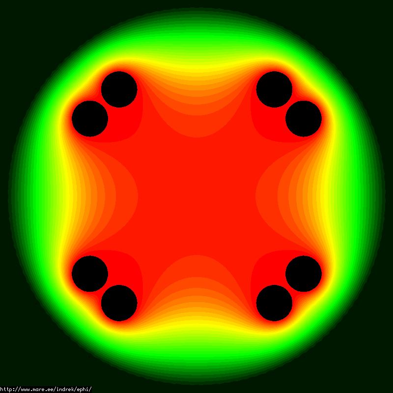

Have you been paying attention? Maybe you need to reread my original post, that also deals with this part of the game. The cusps may be small, but directly along the field line through the middle of a cusp, there is no confinement of either electrons or ions. Can you make of sketch of what you think the electric potential looks like along that line, and how you think the electrons and the ions will react to that potential?
You speak about the ExB drift. When looking at the potential gradient:
According to this and the field lines picture before ExB=0. Can you elaborate? Are you saying the recirculation beam will cancel the e-field as such and instead a potential gradient will form within the beam (perpendicular in direction to the beam), causing the ExB drift?
- Indrek

Post by rnebel »
Perhaps I am misunderstanding this discussion, but there are electrostatic fields along the cusp lines. We've measured them with emissive probes. If they weren't there, I don't see how the electrons would enter the device.
Art Carlson wrote:
MSimon wrote:
If you can't manage to hold them back electrostaticly
That is the whole game.
You know. I do see a magnetic field problem at the cusps. I don't see an electrostatic field problem.
The electric fields lines should be concentric spheres (allowing for actual geometry).
Ions will be repelled. Electrons will be attracted but are deflected by the magnetic field.
