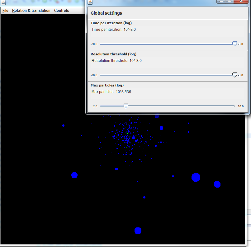

* generic slider panel and slider frame classes are complete and tested.
now adding slider controls is a breeze! as in 3 lines of code!:
Code: Select all
globalSliders = new SliderFrame();
globalSliders.setProducer(elements, "colors");
globalSliders.show();

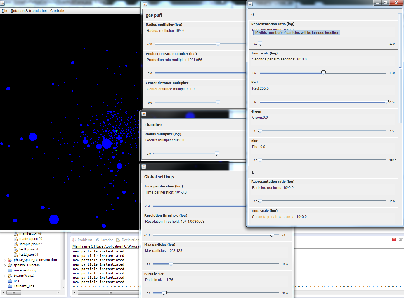

more sliders...

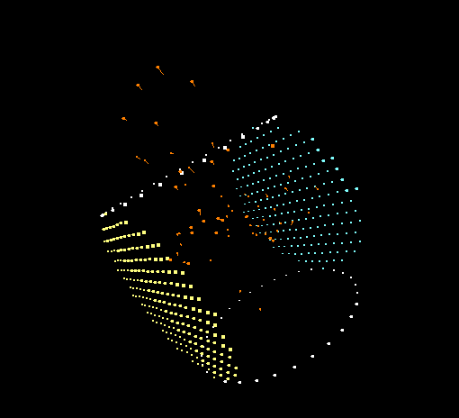

thanks much for the test geometries, preston.
for now i made a simple MHD thruster - a pair of charged lates and a pair of solenoids. the thrust seems to be going the wrong way. i would think it should be going out the sides - current X mag field - current is between the plates, mag field is between the solenoids (the solenoids are just a current loop) but in my test they are going out the solenoids (the top). as shown below.
so i'm guessing there's something wrong with my cross products on the mag field, in the code i posted above.
btw, as you can see, in addition to coils, i now added plates. i also added wires (not shown).

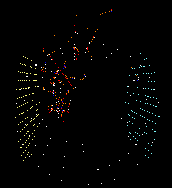

i made it so it now shows the electric and mag field vectors on the particles (as colored lines coming off of the particles), and that helps immensely. now i see there appears to be an issue with the electric field vectors in the presence of current loops. i'm just using a circulating charge to create the magnetic field, and cancelling out its electric field with an inverse non-circulating charge. i'm guessing that might be messing it up, since it means really large charges. so i'm going separate the charge used for calculating current from the charge used for calculating electric field, so that i can have electromagnets with no electric field to begin with, instead of having to cancel it out. then i'll see how it goes from there. i might eventually add visualization to the octets so i can make sure they're updating correctly.
happyjack27
Posts: 1439
Joined: Wed Jul 14, 2010 5:27 pm
Re: particle simulation using fast multiple method
Post by happyjack27 »
Success!
That was the issue - the huge charges on the magnetic coils were leading to precision loss. now that they are chargeless, it works just as expected.
simple MHD thruster:
white = columnb force vector
red = b-field vector
blue = lorentz force vector
orange = "trail" (velocity vector, pointing backwards)
charged particles traveling perpendicular to charge and mag field, as expected.
