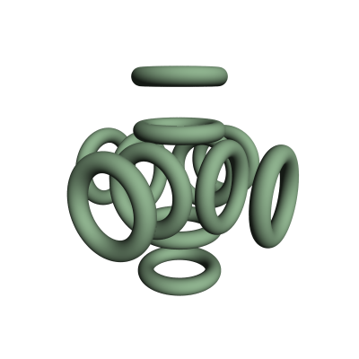

Something like this dual-coil magrid picture Indrek provided
at
viewtopic.php?t=506&postdays=0&postorde ... 7&start=15
but with current flowing in the SAME direction for each coil in a pair, and insulation-covered conducting links between the two coils forming a hyperboloidal helicon, the outer coils being rotatable to adjust the helicon geometry as it's being driven with RF at tens of MHz.
at
