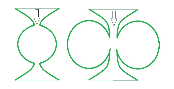

So I was just wondering if the following had been considered as shapes for grids (cross sections attached as a file).
The black arrows represent magnetizing current flow through a charged column, the column having the cross section shown by the heavy green lines.
The field lines would have the wrong shape, not convex towards the focus in the main, but the lack of any but two cusps might make up for it?

I see two possible problems. First a two dimensional drawing doesn't reveal directly the current flow. At the throats the current density is greatest, as the radius of the sphere increases so does the area that the current is flowing through, which implies less current flow per unit of surface area and thus lower magnetic fields, unless you are correcting with increasing wires as the radius expands so that the surface area to amp turns remains constant or within some desired gradient. It might be an engineering nightmare.
Secondly, all magnetic fields must be convex towards the plasma, but at the throats the fields would be concave towards the central axis. You not only need to consider orientation towards the center of the vessel but also the orientation towards the plasma locally (in the throat or regions where the magnetic field changes direction , such as in the second drawing. Macro instabilities may be a problem.

So the current and B field looks like this?
Re: Has this been discussed?
I don't think so, not if that's a cross section of a rotationally symmetric system. The magnetic field inside the structure would be zero.
