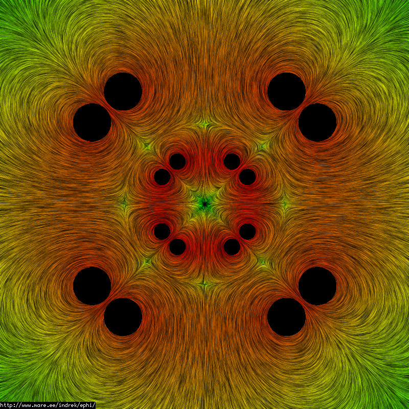

drmike: what I have been working on is the formation and topology of the magnetic field interior to the wiffle-ball. From the hydrodynamic analogy for magneto-statics, it becomes obvious what flow-field will form in the interior of the magnetic field generated by the coils, if it indeed does form a quasi-spherical secondary flow field.
Imagine that the coils are vortex rings, i.e. 6 of them aligned as per the Polywell WB-6, etc and the steady flow would look exactly like this
http://www.mare.ee/indrek/ephi/wb1/wb1off_lic.jpg
Now if a secondary flow were to form in the very center, and it would necessarily be spherical and closed just from the symmetry of the situation, what would that flow look like to observe conditions of continuity and matching of streamlines across the spherical boundary?
One possible solution is using a "method of images" type approach, known as a Kelvin inversion (see sect. 2.8.3, chap. 2, Partial Differential Equations J. Kervorkian) for Laplace equation solution fields exterior and interior to circles or spheres. What this says is that the sources or dipoles (the vortex rings of our coils in this case) that are generating the flow exterior to the spherical surface are reflected (and inverted) in the spherical surface boundary to have virtual, image generators interior to the sphere. When we do this, the flow interior to the spherical surface exactly mirrors (in a spherical inversion sense) that flow exterior to the surface, ensuring that the surface is spherical also.
We would have a spherically inverted image Polywell of vortex rings at a distance ~ "r", (whereby the physical Polywell coils are at distance "1/r") inside the sphere that generates the interior field. The fields near the surface would be an exact mirror image about the surface, in the limit of an infinitesimally flat element of the spherical surface. For example, where the coil-center point cusps have field lines coming down towards the wiffle-ball surface they would stagnate on the surface and diverge about that point. In the interior, the image field lines would come up out of the center and stagnate on the inside of the sphere, at the same point, and around them diverge also, to mirror the divergence on the exterior. And vice-versa for regions of flow near the convergent lines upon the surface, that coincide with the line cusps between the coils.
It is all very lengthy to describe in words but quite easy to visualise in the minds-eye from the equations and using simplified 2D to 3D extrapolation ... thus the need to generate plots/fields, etc.
It is a well-known analytic solution method (obviously only to a first-order) that I think has much merit for describing the magneto-static fields for a spherically-inverted secondary flow. If there is such a secondary field (flow) that is forming with the "wiffle-ball" there is only a limited number of correct topologies that can be forming. The Kelvin inversion is the first place to begin looking at what the field will be looking like, and will be quite correct very near to the spherical surface.

Art Carlson made this suggestion in another thread sounds similar? I think if you've got a solution it would be a huge benefit to many simulation attempts.
It is somewhere between possible and likely that you need to do some work to get into the high beta regime of interest. The easiest way I can think of to simulate that would be to put a superconducting ball into the middle of the configuration and to start the electrons from the surface of this. This may not be as hard as it sounds. I think if you go to circular coils, you can use image coils within the sphere to produce a magnetic configuration with zero normal field on the surface of the sphere.
Carter
