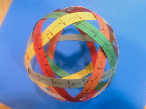

Hi All,
I have invented a spherical electromagnet that I think might be useful for containing plasma and perhaps for maintaining a fusion reaction.
A photo of it can be found at the following link along with a full illustrations and explanation of how it was built and how I imagine it can be used.
The invention is in the public domain.
http://www.justodians.org/SphericalMagn ... agPic1.htm
Would someone please look it over and tell me if it has a use?
I am also curious to know if anyone else has invented this before me.
Thanks, John
Thanks, John

Hi Solo,
>I guess this would suffer the same issue as my proposal to join the edges of tombo's single-turn coils: the corners will have a field null.<
This device is actually 6 different interlocking coils of wire which are meant to be turned on and off in sequence. The idea is not to contain plasma but rather to juggle it. The following portion of the abstract should make this clear.
This invention proposes that the location of the poles is constantly changing. This is accomplished by varying the current running through the six interlocking coils of wire. So as the hot plasma moves near the poles to escape, that exit is closed before the plasma has a chance to reach it. The plasma now moves towards a new pole and so on around and around inside the bottle. This motion creates a secondary magnetic field within the plasma itself as it spins inside the bottle. And because the axis of spin is constantly changing, a magnetic vortex is formed pushing and pulling the plasma to the center of the bottle.
An interesting experiment would be to hook up a signal generator to 6 channels of digital delay and then into 6 channels of amplification. Then send the amplified signals through each of the six coils of the spherical magnet. The spherical magnet will have a balloon in the center filled with water and iron particles in suspension. By fooling with the signal and the delay, I expect to be able to make the iron particles move about inside the sphere like a school of fish. Since plasma also responds to magnetism, the implication is that plasma may be in controlled the same way.
The full patent application can be read here:
http://www.justodians.org/SphericalMagnet/PatentApp.htm

Whoever came up with the shape in your first link was wrong. The correct dodecahedron configuration was just like you designed.
Regarding the AC idea, Keller and Jones published a paper in 1966 where they tried to do what you were talking about. The paper is entitled "Plasma Confinement by AC Polyhedral System" I think they achieved some success but they ran out of funding so the idea was not fully explored

That's a sweet little mock-up I like it.
It did not appear right at first, but ok the currents all go the right ways.
But, I agree with Solo about the intersections.
Although a very close detailed look at the intersection fields might show some resolution.
Can you do it with Bitter Coils?
I like your tooling.
But, I can't quite picture how the loom works.
It seems that while winding one turn the others would tangle.
Or, does it work out that they all go the right places?

Hi tombo,
The way that you are thinking about using the coil arrangement is different than I had anticipated so in order to give you intelligent answers I will need to study the polywell concept for a few weeks. However, I am prepared to give you answers that are not very inteligent right now.
>Can you do it with Bitter Coils? <
It seems that a Bitter coil is meant to be used with DC according to http://www.oersted.com/magnetizing.PDF so I am guessing that your intent is to use the coil as an anode or cathode as opposed to an AC magnet. In any case I think it is possible to construct the magnet as interlocking Bitter coils as long as you make it in the form of the popular cat toy appropriately called the Nobbly-Wobbly. The cat toy is shown below.
![Image](http://www.strictlypetsupplies.com/product_images/dog/toys/multipet/nobbly_ball.jpg)
I like this toy very much because this is how I imagine electrons manage to avoid colliding with each other as they travel around the nucleus of an atom. In any case, I think interlocking Bitter coils could be constructed in this fashion.
>But, I can't quite picture how the loom works.<
I am afraid it's not a loom but rather just a simple fixture. I had to take each spool off it's post in sequence and wrap it once around the soccer ball, repeating the process 50 or 100 times until it was done.
The process could be automated but only with a machine that is capable of passing the spools around obstacles. A robot arm would work fine.
The magnet is now in the possession of Chuck Hoberman. I have brought it to various smart people to see if anyone has a use for it. I would be happy to send it to anyone in this forum who thinks it might have a use and wants to test it's properties.
Thanks, John

I don't think so. Here's Tom Ligon's ISDC presentation with dodec mockup on p24:Whoever came up with the shape in your first link was wrong. The correct dodecahedron configuration was just like you designed.
http://isdc2.xisp.net/~kmiller/isdc_arc ... ile_id=422
A polywell can't have intersecting magnets. The electrons follow the field lines. It would be like using permanent magnets.
Bussard believed a dodec would give a 3-5x better density ratio, if I'm remembering Valencia correctly. It's probably minimally noticeable at WB-7 size, but at WB-100 size that increased density could help a lot.

Hi Solo, tombo, and TallDave,
You're probably already thinking this but I might as well say it out loud.
What about a coil arrangement demonstrated by the cat toy above?
This is the same configuration as the spherical magnet found at the link below.
The only difference is that the coils of the magnet intersect where as in the cat toy, the rings are bent so as to avoid intersection. What if I were to make an electromagnet configured like the Nobbly Wobbly keeping all the coils away from each other with plastic or ceramic spacers? Does this address the issue of field null at the corners? Does this have any use as a polywell?
Also, please notice that the spherical electromagnet and the Nobbly Wobbly configuration both have 12 pentagonal openings evenly spaced around their surfaces. So I can’t help but wonder if 12 windings in the dodecahedral polywell configuration could sit on top of (but not touching) the 6 windings made in the Nobbly Wobbly configuration located by the 12 pentagonal openings. In other words, why can’t a spherical electromagnet sit inside a dodecahedral polywell? Maybe if all the magnetic forces are working together, perhaps this might make for a tighter packing of electrons, which might increase the likely hood of collisions.

Hi tombo,
![Image](http://lh3.ggpht.com/_24xOsZHh7Fw/SRxN6sOk1CI/AAAAAAAAAJs/H5eo1ml0ZKE/s512/Crossed_Top.jpg)
![Image](http://lh5.ggpht.com/_24xOsZHh7Fw/SRxOBBkwN8I/AAAAAAAAAJ8/L2e8VF-pEn4/s512/Crossed_Side.jpg)
I am not interested so much in promoting this coil arrangement as I am in promoting the idea of running a lot of random experiments over as short a period of time as possible. That's the method Edison used to come up with a viable light bulb. Even Dr. Bussard was not able to predict a viable polywell on the first, second, or even the third try. If we all arrived at this place and time through the process of evolution then we ourselves were bumbled into existence. So for earlier success, lets bumble faster. Please understand that I am not advocating for the type of copious experimentation they are doing with tokamaks. They do not seem to bumble so much as plod.
I followed your advice and checked how original spherical electromagnet might behave according to the right hand rule. Of course it all depends on how the current is applied to the six coils and there are an infinite number of ways to do that, but one interesting result is shown below.
![Image](http://lh4.ggpht.com/_24xOsZHh7Fw/SRiYSOFzEYI/AAAAAAAAAIc/jiB0Lk8VO58/s512/SideViewMashed.jpg)
![Image](http://lh6.ggpht.com/_24xOsZHh7Fw/SRiYQxdWy8I/AAAAAAAAAIU/aA_3Nz0fGrQ/s512/TopView.jpg)
The effort making these models has caused me to wonder if this type of coil arrangement lends itself to making logic gates according to the principles of the magnetic amplifier. So I am off to bumble in that direction for a while.
Thank you again for all your help and encouragement,
John

I like the way you have documented the current and B field vectors on the paper tape model.
It shows clearly that I was wrong in my vision of where the fields went.
Oh well there goes another one.
It has been a long time since I used paper dolls to model parts.
That is a time honored engineering technique.
Sometimes we get so stuck in our computers that we forget to use the simpler easier tools.
I think field nulls are bad where-ever they are located.
At least that was what I was told by the more experienced members.
Also the more spherical the fields are, the better, in order to preserve the whiffle ball cusp closing effect.
I keep thinking that there has to be a way to make the fields visible in 3D.
Maybe something like iron filings suspended in vegetable oil.
That way you could see what the fields created by your wire model look like.
