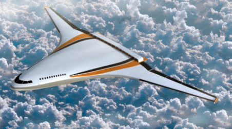

Fuel-Sipper - the Turbo-Electric Flying Wing
45,000,000 We / 90,000 lbf = 500 We/lbf with superconducting motors.
{About twice as efficient as the F-35B lift fan's (mechanical power in)/(lift force out)}.
So, using this thrust efficiency for a very rough estimate (ignoring fan, motor and duct efficiency differences between VTOL hover using rotating motor-fan ball modules and take-off using an aft-dorsal, linear propulsor array) a vehicle weighing about 1,000,000 lb (747-8 class) with superconducting motors would require
(1,000,000 lb)(500 We/lbf) = 0.5 GWe
to hover in VTOL mode.
An order of magnitude less electrical power than needed by the REB for boost into orbit.
Hence my "hover or cruise all day before and after orbit" philosophy.
[EDIT - fixed dead link, added picture and F-35B comment]
[EDIT - Picture link above gone behind paywall -- uploaded below and added link to NASA paper]
https://www.aiaa.org/uploadedFiles/Abou ... an2012.pdf
The peak reentry speed of Rutan's suborbiters is about 1/5 that of a vehicle returning from orbit. Significantly different heat loads. I'd rather keep the rotating parts/joints on the smallish side, within the overall aeroshell envelope.
Key point. Nice.
DeltaV wrote: (1,000,000 lb)(500 We/lbf) = 0.5 GWe
Coincidentally, this is the total output of a coal-fired power plant I used to live near.
One coal plant for hover. Ten coal plants for orbit.
Which is why this will only work with fusion, or something better.
