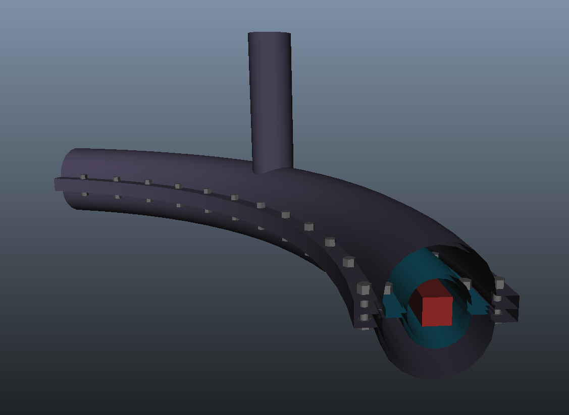

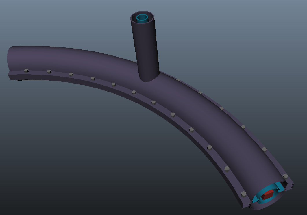

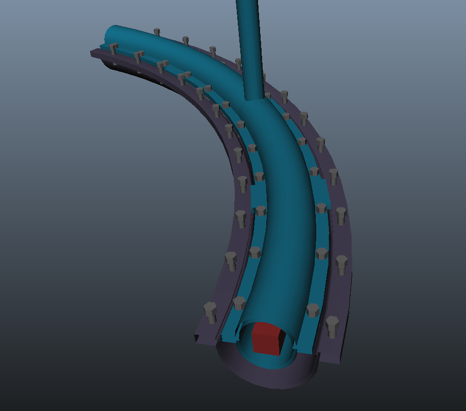

updates:
as you can see shrinking the size further is limited by the diameter of the nuts and bolts holding it together...
Do you see what I mean now about the feed-thrus?
I still think there will be massive issues separating them. I mean yes, you could use L-joints with holes cut in them, but whatever you do to one feed-thru you have to repeat at least TWENTY-FOUR times... and you've got at least five pipes! 120 separate parts JUST for the cooling? and all of them need to be welded to an extremely high quality? No, I think that's getting way out of hand and is setting yourself up for failure.
There must be a more elegant solution. any ideas?

Re: superconducting magrid design
Jon117,
Just brainstorming here, why does the back side of the coil need a water jacket? Further the chamber itself is vacuum. That should simplify things a lot, no? There still needs to be structural material, but the nesting is cut way down I think.
Also, isn't the LN only needed between the water jacket and the LHe? So, is nesting LN around the LHe needed for the feed throughs? Of course outside of the vacuum chamber things change, but if it is too much trouble, maybe that can be the point to go to LN cooled copper, or water cooled copper, or just copper?
Another thought, what about putting a circular copper bar on the backside for loss of SC state and current collapse, to keep the B field from collapsing? Isn't that standard SC magnet precaution?

Thinking there must be a more compact way to fit shells together than those flanges. I'll be back when I have an idea illustrated.
Flanges are because the upper and lower shells are bolted as opposed to welding them as was done by Bussard in WB-6. Is that right? Still, on the previous drawings, there were no flanges, but the halves were bolted.

I'm thinking construction would be in three parts:
1. bottom (plasma facing) assembly with water jacket, LN jacket and insulation (vacuum zones)
2. Sc and helium shell assembly (I'm thinking seal welded)
3. top assembly, just vacuum, maybe inner shells for strength, maybe not.
As far as I can see the top and bottom assemblies could be bolted, or welded together.
