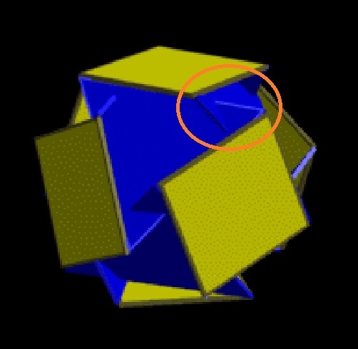

Fold-up Polywell
When you need to travel with a fusion reactor in your carry-on bag...
(From http://www.polyhedra.jp/polyhedron/js/zindex.html )
The coils for these arrangements interfere if you try to fold them...
Re: Fold-up Polywell
It's harder to see in the first 2, but I think those also have interference when folding.
You're right. I should have viewed it with IrfanView (hit 'G' to stop animation).
The solution seems obvious...
Conform the coils to lie in nested spherical shells, with small differences in diameters.
But that may not work either since the triangles seem to hit near the corners, where the pivots are located.
Maybe raypeters or tombo can do a CAD kinematics study?
Juno may already have solved it -- hard to tell with the transparent linkages:
http://www.polyhedra.jp/polyhedron/js/z12photo.html
Looks like it could work if you allowed the coils to be non-rigid.
Would like to see a mag field sim during expansion, if I only had the time...

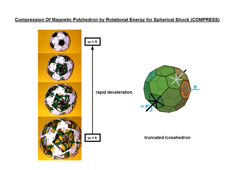

Cooling is not a problem for pulsed machines.
Power can be transferred through slip rings or rotary-inductor/-capacitor couplers. [EDIT: capacitors... better for high-power transients]
Could also use permanent magnets.
Magnet repulsion acting on the sphere means that the forces are primarily tension. Best case. Thank God it's not bending moment.
But the real secret is a good acronym.

Well, the first one won't work.

I assume that you are referring to N vs S directions. Yes, the facet arrangement will need to allow all inward (or outward) poles (even if with the expense of intercoil gaps and "funny" cusps). But the general idea of rapid rotational compression has a certain steam-punk appeal for pulsed operation.
Consider a Project Orion inspired arrangement using an even number of rapidly counter-rotating, truncated icosahedra. Space... already in vacuum. Inject fuel puffs. Spinning polyhedra with nozzles on one end (symmetry axes aligned with spin axes) are simultaneously, inertially actuated into compression using disc brakes. Torques cancel. Ka-boom-boom.
Ooops. Not synchronized...
Ka-b-boom.
Almost got it...
Ka-boom.
Perfect!
