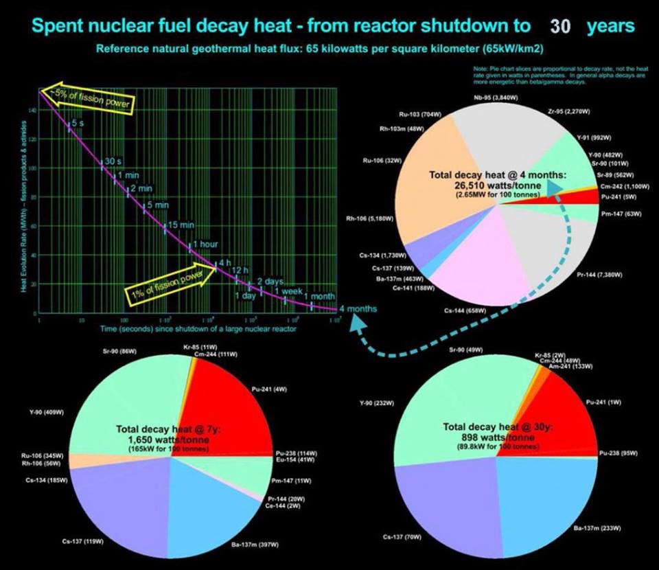

False. Fission definately DOES have an off switch. Fission product decay on the other hand does NOT. But therre is a certain, limited amount ofenergy that needs to be handled.
If I understand correctly, Chernobyl slag (the "elephant foot") is sub-critical, but still too deadly for man or machine to approach -- hence the plan to contain. Maybe Fukushima is more like that than I realized. Except Chernobyl seems stable -- no cooling water needed. What would happen at Fukushima if the water was turned off?
Chernobyl has been decaying for ~30 years. With a 1GW reactor, the decay heat after ~30 years is ~900W. Fukushima has been decaying for about 5 years. It should be evolving ~2 to 3 kW.
