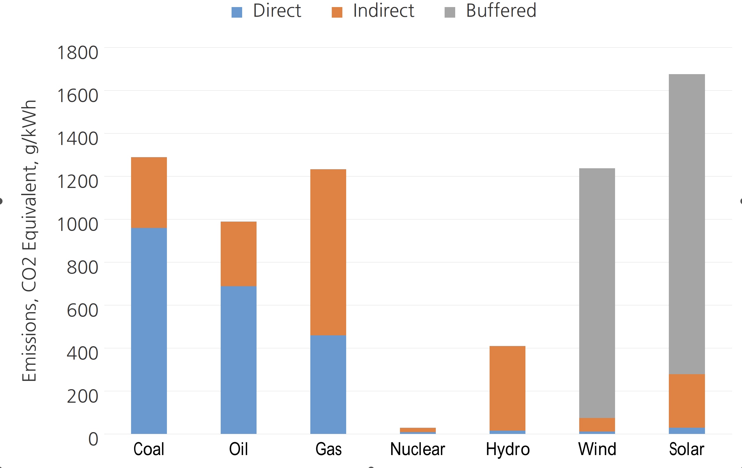

Posts: 6193
Re: For the "Greens"
Mon Oct 02, 2023 7:28 am
KitemanSA wrote:
Sun Oct 01, 2023 10:08 pm
I had all that stuff until I was evicted from facebook.
I found the reference.
Markadya A & Wilkinson, P. (2007). Electrical Generation and Health. Lancet 370(9591), 979-990
Sadly these are truths that almost no one wants to hear...
Check the attachment.
The colored bar segments was from M&W and the grey was the info on buffering that I added.
KitemanSA wrote:
Sun Oct 22, 2023 7:48 am
It gives quite a different truth, but convincing the laymen about it is a whole odyssey.
