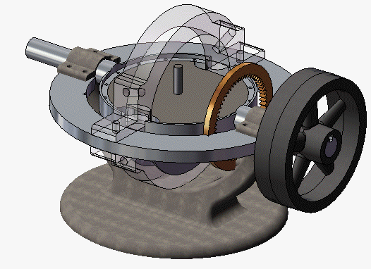

Duke was probably inspired by this engine from a century ago:
http://www.douglas-self.com/MUSEUM/POWE ... C.htm#treb
I reinvented this one (on paper), only to discover that it dated from the Civil War era:
http://www.douglas-self.com/MUSEUM/POWE ... g6.htm#ber
Some other inspiring designs from past centuries:
http://www.douglas-self.com/MUSEUM/POWE ... /tower.htm
http://www.douglas-self.com/MUSEUM/POWE ... eng6.htm#f
http://www.douglas-self.com/MUSEUM/POWE ... .htm#chris
The hard part is sealing against high pressures. "Area" seals are much preferred to "line" seals.
