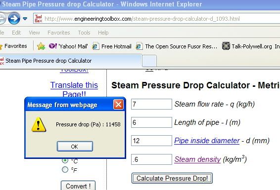

There would be one other totally telling point, but 'fraid I have not done fluid flow for a couple of decades now - can anyone do this calc:
Even Rossi is saying that the speed of the gas would be in the order of several m/s. For a flow rate like that and a length of 6m or so, there would be an associated pressure drop. What is the pressure drop? Because the way I see it, it is quite possibly be enough that the boiling point would be raised a little in his device - but only if there is the flow rate [he is agreeing] of several m/s.
Can anyone do a quick plot of pressure drop versus gas veloocity for steam through a 1/2" ID 6 metre pipe?

chrismb wrote:Can anyone do a quick plot of pressure drop versus gas veloocity for steam through a 1/2" ID 6 metre pipe?
http://www.engineeringtoolbox.com/steam ... _1093.html
I did not follow the link, but does it account for moisture level? Or do we assume dry steam? It would seem so, after I looked at the link.
OK, perfect. Well, it's a doddle to push this house of cards over, then!
So we have;
In other words, if there was a flow rate of 7 litres/hr of dry steamcoming out of the pipe, then there would be a pressue drop of 11kPa. As we know the pressure at the end of the pipe is ambient, so the pressure in the E-cat must be just over 1.1 bar, and the boiling point at just over 1.1 bar is... around 104 degrees C, I believe.
So either he's not boiling water at his measured 100C in the E-cat, or he's not flowing 7l/hr. He can't be doing both.

chris
There is no way BP can be 104. Because only way to get stable 101 is if BP is 101. Therefore flow rate must be ~2l/h?
Where does the 7l/h come from? What assumptions?
Of course, BP 101 stable proves steam is wet (or it would not be stable, as I pointed out earlier).
Tom

tomclarke wrote:Where does the 7l/h come from? What assumptions?
No assumptions. This is Rossi's claim, and how he arrives at his power output figures.
