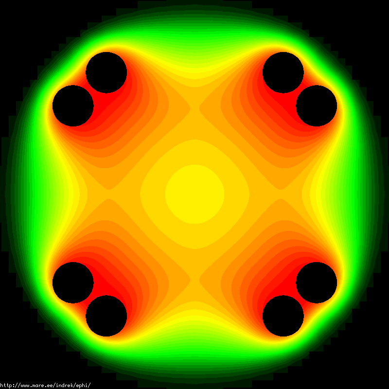

My point there was not as much as that the well won't form at all but rather the _effective_ well depth for ions will be limited due to the coils having big holes in them (the other half of this mail is actually about an entirely different idea - you have to read the thread).
Going further have a look at this picture of the potential in a simulated polywell:
This is from my (not that perfect) plasma simulation. In this picture the potential in the middle is quite low compared to the coils. But the recirculating electrons through the faces reduce the effective well depth - the ions will be able to escape through these holes.
The revelation I guess is that polywell can't work with recirculation alone - the effective well depth will be poor. The only salvation could be in the wiffleball.
But just in case I have to state here that my plasma simulation lacked important elements, was low resolution and I didn't manage to verify its correctness. So my results in this regard should be taken with caution.
