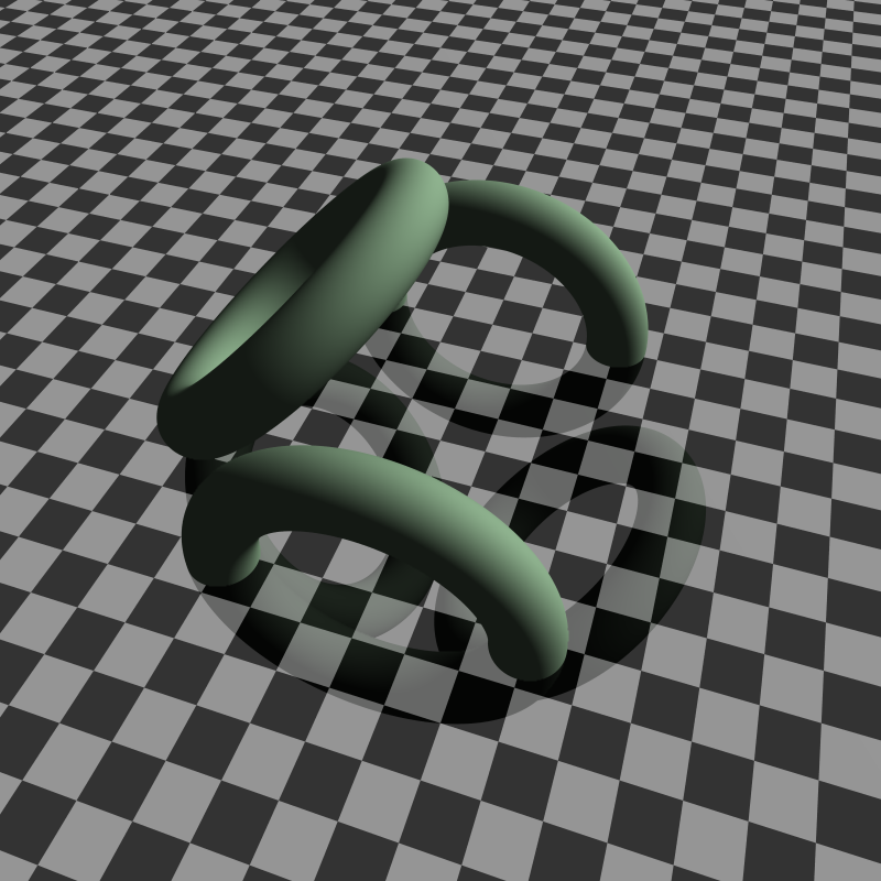

This is all very impressive, thanks for your work. But as I look at it I am trying to figure out the orientation of the different pictures. Are they "sliced" diagonally through the center of the "cube" so as to slip between two adjacent faces while cutting through both mutually perpendicular faces? And then again slip between the faces on the opposit corner/vertex?
That is the only way I could figure to only have four intersections of the MaGrid, and would also account for four electron guns from your 3-dimensional set-up picture. Please let me know if I missed something.

Yes. This is a cut through the "corners" of the cube polywell.
I tried to visualize it here, removed one of the top coils to make it more understandable:
http://www.mare.ee/indrek/ephi/pef8/cut.png
The checkerboard is the plane with the 4 coil intersections.
- Indrek
- Indrek
